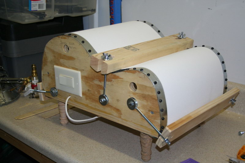

I already built the bender. Its 14 inches wide and is covered with 2 pieces of sheet metal. I put some canvas on top of that. The "cover" is another piece of canvas and another piece of sheet metal, basically to sandwich the wood. I have 4 bulbs inside.
Very close to Sloan’s design with exception of the lights, width and top.
I went with 14 inches because I originally planed on doing sides for 2 guitars at one time. That was before I realized I didn’t have to leave the wood on there for a week.
Does that seem ok?

PostPosted: Mon Nov 20, 2006 8:52 am
Posts: 200
[QUOTE=Hesh1956] Alan I thought it should also be mentioned in the thread that Side benders have been known to start fires.....
If you end up upping the bulb wattage which I think that you need to do too your bender will get very hot. You have also mentioned that canvas is part of the bender.
With this said please don't leave the thing unattended at any time if it is on and/or plugged in.
Some folks here will install timers as well as an added safety feature.[/QUOTE]
Should I get rid of the canvas?
Here is a photo with out the "lid". the lid is basicly the same as the top...
PostPosted: Mon Nov 20, 2006 9:16 am
That's cute. Looks like a little pet.
I would get rid of the canvus and just use the steel slats. Add a couple more bulbs and I think your good to go. Although I would be worried about the bulbs being to close to the wood. If you had 200W bulbs in there, I would think you would have scorching.
How are the bulbs lined up? Is there a bottom to this rig? Do you have any other pictures for us to try and help out a bit more.Rod True39041.7216203704
PostPosted: Mon Nov 20, 2006 9:18 am
Posts: 200
[QUOTE=Rod True] That's cute. Looks like a little pet.
I would get rid of the canvus and just use the steel slats. Add a couple more bulbs and I think your good to go.[/QUOTE]
With exception on the bulb it's hollow on the inside.. so slats.alambert39041.723587963
PostPosted: Mon Nov 20, 2006 9:19 am
Posts: 200
[QUOTE=alambert] [QUOTE=Rod True] That's cute. Looks like a little pet.
With exception on the bulb it's hollow on the inside.. so slats.[/QUOTE]
thats NO slats.alambert39041.7237847222
